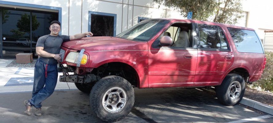

Has anyone done one of those 3.5 inch bodylift on their 1st generation expy? I have a suspension lift already and looking to install a bodylift. I do know they come with extension for steering shaft, do I need to extend anything else? thank you. I am not worried about bumper brackets, they serve no use for.me. thank you.20210708_171933.jpg

Hey, I don’t believe there is anything else that need to be extended. I did mine about 2-3 years ago.

I know you have to extend the steering shaft, it comes with an extension. right? where did you buy your bl lift? thanks

Fuel fill hose will interfere with the frame past 2" 1/2 inches of body lift. Mine is touching the frame and I used double stacked hockey pucks for my body lift.

Keep an eye on the shift cable, anything connected to the body and frame ( wires, hoses, etc. ), You will need to remove the lower portion of the fan shroud. Can't remember everything bcuz it's been a few years since I did mine. Wasn't too much though.

Mine came with the steering extension, my fuel filler hit the front or something, uses some old radiator hose to insulate, no problems.
