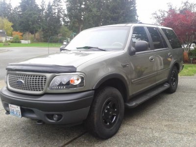

I just found a 5" kit for body and leveling for ~$380.00
Ford Expedition suspension lift kits by Fabtech, ReadyLift
this is just body and leveling not the coils or any thing... that means i can get away with 11" of lift on my expy im so excited and im also contemplating killing my rear air and swicthing to coils because it jsut saggs after 13 years of being the back bone of family vacations.. and my dad and i replaced the bags last year when it was my parents car so they arent popped
