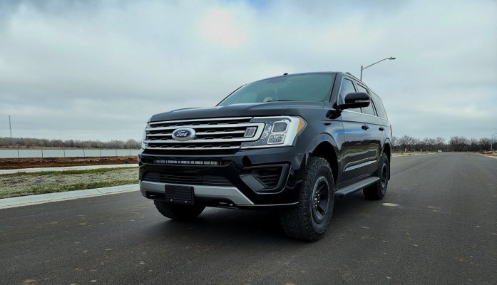

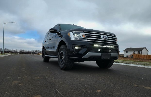

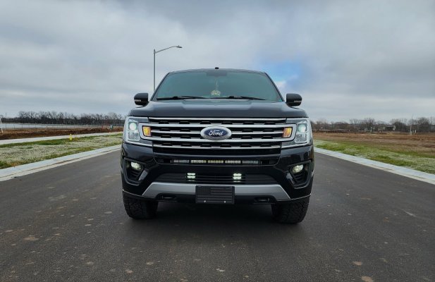

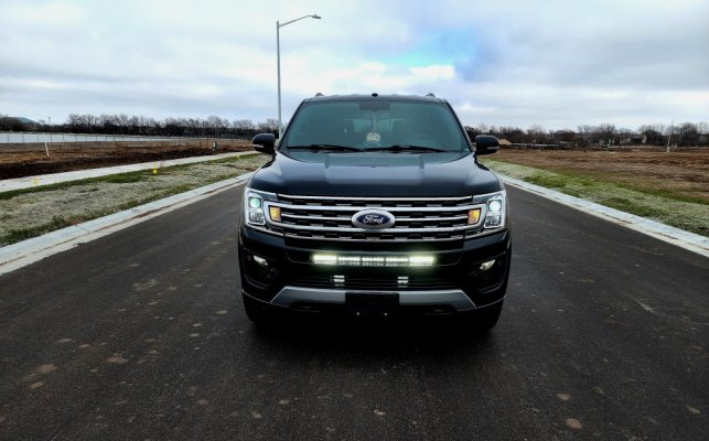

Our '19 Expedition has gone through some suspension, wheel & tire changes. Now with the really poor factory lighting it was time for some major upgrades. We make a 7hr one way trip to the wife's family about every other month and most of it is 2 lane highway, plus I prefer to drive at night. Anyway.....
Diode Dynamics 30" combo bar
Diode Dynamics SS3 sae fog sports
Diode Dynamics SL1 low beams
I tinted the factory fogs and re wired to act as running lights. SS3's are now using the factory fog switch. Light bar is on an independent switch.
Waiting until night time to get them aimed but so far I'm happy with how it turned out and the wife is thrilled....since it's hers.

Interested to see how the output is with it being set back inside the grill like that.

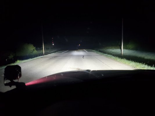

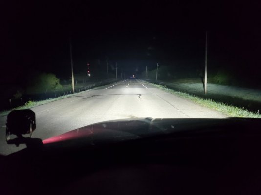

I'll try to get some as soon as I can. I work evenings so I'm out the door before it's dark. I have the 30" on my truck that's all driving lenses and it's amazing. This pic is slightly misleading because it shows my lows, fogs and ditch lights but you can see the distance from the light bar. 2nd pic for reference is lows, fogs and ditch lights.

I'm still waiting on our Expedition so I don't have one to examine. Quick question- that horizontal 'plate' that you mounted the new lights onto, is it a standard/stock piece there? Or is it something you fabricated for this project? Really love the look of this clean, stealthy installation. Merry Christmas and safe travels!
I've got my light bar mounted behind the grill also and it works well. I mounted mine on threaded rod so I could fine tune the position once it was in.
Both lights were mounted to the factory plastic piece that's behind the bumper.
Only change I may make is to use the same mounting point for the fogs but using a longer bolt and a spacer to drop them down about 1/2 an inch.
