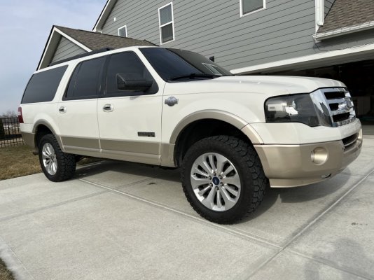

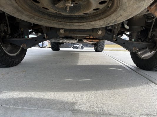

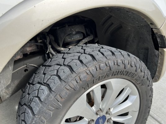

I have spacers in front and air shock relocation in rear. On 32’s now, but could clear 35’s with different wheels.1E12D623-250F-421F-A136-7A947BE8FD22.jpegBA38A950-EB7D-4051-AA17-BD336F9D8338.jpeg

So my mechanic said there is no life that he can find that will fit my tires I’m guessing there are to wide at 12.8”. The tires are 325/60r20. Anyone suggest a lift that would work with that tire.
I'm running Raptor wheels with 315/70r17s and they fit fine. That's a 34.5" tall / 12.5" wide tire. The Raptor wheels do have a slightly different backspacing to allow things to clear so you might just need to run a 1" wheel spacer if width is your issue.
My setup is Bilstein 5100s in the rear (middle notch) and Rancho Quick-Lift struts up front.
