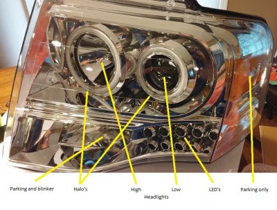

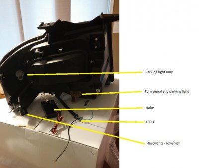

I know it has been almost two years since you posted this, but I was wondering if you could help me?
I have purchased the Anzo Halo headlights just like you have here. As noted, they come with NO instructions. I have watched a video (or twenty) and think I have a grasp of this, but was wondering if you could shed some light as well.
In the pictures below, I have labeled the wires from a back view of the headlights and labeled the lights from the front view as well so that you can see what MY understanding is.
What I am supposing I need to do, from watching the video(s) is:
1) wire the black wires together from LED set and Halo set and attach a connector (female)
2) wire the green wire from the LED set to the red wire of the Halo set and attach a connector (female)
3) from the parking light on the side, connect a black wire (ground) and a red wire (hot) to the respective wires of that set and attach connectors (male) to each of those wires
4) plug the males and females together and watch the sparks fly (well, hopefully no sparks)
Is this how you did it?
