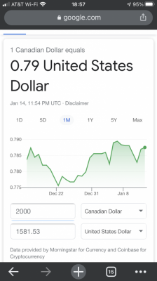

Its 2k Canadian dollars, but still damn! He must have CCD.
