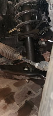

3rd shock blown out on 2018 XLT
xRichx
Apr 1, 2019
Estero FL
Dropped ours off yesterday for 1 visual leak and the service agent called me later to say they were replacing all 4. 3 showed leaks and she said it’s a matter of time before the 4th one starts leaking. Hoping these replacements hold up longer.

What color is the shock fluid? Or is it clear like mineral oil?
Yes, it is pretty clear. When I first saw mine leaking I thought it was water that had dripped off but when the puddle was still there the next day I realized it wasn't water. Its pretty clear and thin.
