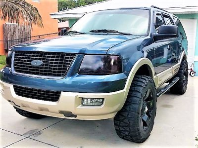

I have not had the opportunity yet to take in the snow. I got them on March of 2016 and live in So Cal but I also have a place in Nevada. I will be going to the mountains in the next few weeks and will be able to let you know about snow then. I had the 33" Toyo open Country A/T before that on my stock set up (tough tire got about 60k out of them and still gave them to someone who is still using them) So far they have been great in rain and mud, climbs way better. I have read mixed reviews about the R/T in the snow some say they are great some say they are not. I put a good amount of miles on my truck every month 4k to 5k.
Jb14
Oct 1, 2012
281
64
California
That set up looks good. No the Bilstiens are separate. I replaced pretty much my entire front suspension. Strut wise I replaced, Struts, springs,mounts the entire pack. I also replaced stabilizer bushings and ends, inner and outer tie rods (if do again I would do entire steering rack and pinion comes with inner rods) upper control arms, lower A arm outer bushings, Wheel bearings, brakes rotors, brake lines. None of these seemed to be and issue but at 230k when I change felt it was time and figure since taking apart do it all.
Our vehicles are really capable off road but upgraded after market parts are hard to come by actually they do not make them. I ended up using Moog constant rate springs works well but if I were to redo I would go with variable rate springs.
The trimming is minor I got the best price from 4wheel parts and had them install since they do this all the time they hd the trimming tool again really minor trimming and its only plastic being the bumper cap part. Note: 4wheel parts sucks on service if you have one in your area so beyond installing tires they are a no go.
