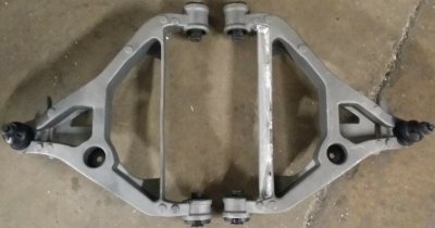

I primarily went with ProForged components as much as they manufacture for our rigs. Anything HD or Extreme Duty made by a reputable manufacturer. I went further, taking my lowers to my fab guy and having weld on gussets.
