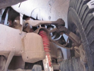

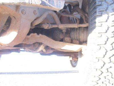

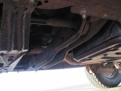

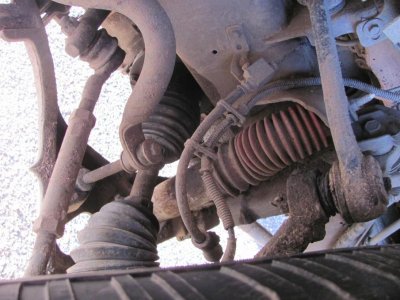

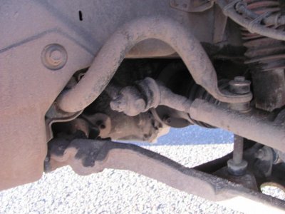

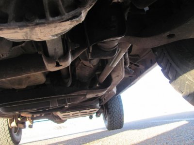

Could some one on hear post some pics of the 1st gen 4wd front suspension (mainly the engine cradle, front axle mounts, Torsion bar mounts and the A arm mounts)? This will give me something to compare to see how hard this project would be.

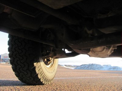

I got some quick pictures last night, but if I go home next week, I will be rotating my tires, so I could get some better pics.
99 Expy
Feb 19, 2010
1,018
Laramie, WY
Hope these help. Mine is a 99 XLT by the way, but should be similar to yours. And when I rotate my tires, I will get some pics of the mounts.

I have the 4.6, so I think my axle might be different than yours, but the mounts and everything will be the same. If there is a difference, make sure to go with the bigger axle since you have the 5.4, and throw in a locker diff to make sure you do it right the first time :waytogo:

yeah congrats man! but it should work out good. and the front axle is the same for both the 4.6 and 5.4. so no worrys there. you will have to do some welding though. since i think the front cradle is welded to the frame. ill have to look. im going to be busy once i get off here, so cant take any pics, but ill try and get some up this week for you.
