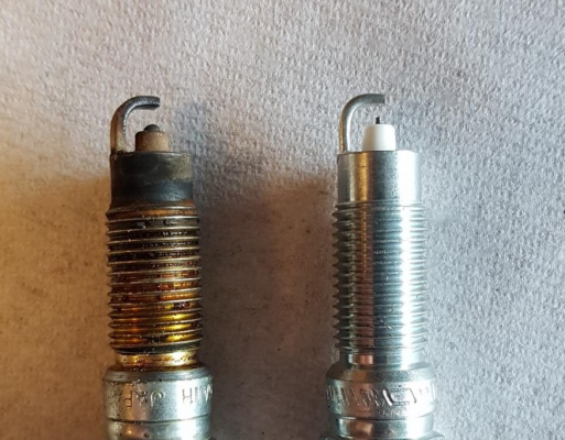

Here's the picture of before and after (original plugs vs what I installed). Old one was past .070 on the gauge. Still a big improvement, lol!
