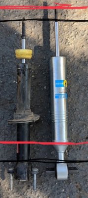

- Those who have extended travel shocks - have you had to use limiting straps in order to avoid damage to suspension components due to excessive down-travel? I've found that the Bilstein 6112's for the F-150 that I have installed in the front allow for an impressive amount of droop, though I'm not sure if it's out of the design range of the stock UCA's.

Also you aligned the mounting points as your basis but if you align the tops of the shafts. The travel inside the shock is likely more similar in distance than it appears from your picture. Do you have a picture of both the OEM and Bilstein fully loaded?
The spring is also slightly longer because using the lowest setting for your snap ring on the Bilstein the spring perch may sit lower than the OEM part

I have crudely added lines showing actual length of travel (presuming there are no stops in either shock body).
Red for Bilstein and Black for OEM measure the distance between the black lines and measure between the red lines and your number will be very similar unlike measuring from the top red line to the bottom black line which you are making your comparison for overall length which does not exactly correlate to over all travel based upon the shock alone.

I think you're right. i.e. The Bilstein 6112's may not improve the wheel's range of motion (travel)... but rather just displace the same range further down - similar to adding a spacer. I don't have any side-by-side pics of the assembled units because I had to use the stock top spring mount on the Bilsteins. :(

I was visually (crudely) measuring from the bottom mounting point (which are aligned in the side-by-side photo) to the top of the polished section of the piston rod (where the top spring mount would meet). But again, the longer shock body most likely cuts into uptravel, netting no more range of motion, but rather just a downward displacement of the same travel range.
