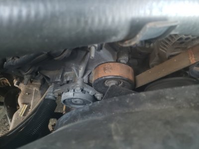

I hear your arguments and know that you are correct. I did spray ether down the throttle body and got it to start momentarily. That and the fact that when turning the key on, no sound whatsoever comes from the tank area lead me to believe the pump is dead. The fuel smelling rotten and the amount of spiderwebs underneath the vehicle supports the idea its been sitting for years. My brother seems to think the owner told him 6 years. I was under the impression it sat for 6 months. My brother interacted with him online, I spoke to him in person. So I think I believed what I wanted and he didn't correct me. Either way it hasn't been operated in years. The relay test would be the way of being certain before dropping it, you are correct. Don't know the procedure for that so I will have to research. I am probably going to have to drop it anyway but by verifying the relay thats one less thing to do afterward. Thank you for the advice and I will keep you updated. Oh I forgot one other tell about the years of non operation, see attached photos.

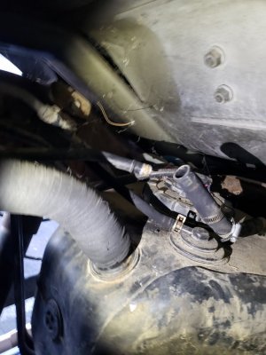

Good thought. My Brother who came to town to help me tow it home thought if that and its not that. I dropped the tank( 2 days, time constraints and lack of proper tools ) and got it out from under last night. Just pulled the pump out and it is the problem. I verified this by checking for voltage at the plug that connects the pump. I will be updating the original post with pics if you are intrested

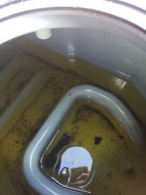

I have found the issue and it is the pump. I had some troubles getting the tank down. I decided to drop it as fuel smelled rotten and I just needed to know what the condition of the fuel system was in total. So without verifying relay was good and I had voltage to the tank I undertook the removal. So..
I was left a bag of tools by my Brother and I just assumed he left me everything. I get under there and assess what I need. Go the bag and no 3/8 sockets and no swivel. So a trip to Harbor Freight and I'm back to loosening bolts. Gets dark and push til next day. Next day get out there late and undo 3 of 5 bolts leave 2 barely hanging. Pull filler neck hose and one other line that is right there as well. Dark again. I come out next day and get all the way to the bigger of the 2 tubes dropping into the tank. The ones with the special quick release tool. Everything is disconnected but that and I fought it for over 2 hours before I got it disconnected. For me the problem was one of angles and position with which to attempt. Anyway it is free at 8 pm and out from under half hour later. I drug the tank onto my front porch and retired until this morning. Just unscrewed the cap and pulled the pump. The pics should show that the tower was covered with a salt crystalline looking yellow and green corrosion. Also the rubber boot/cover at the bottom has turned into a black sludge goo. Not all of it but over half this cover was intact the other half had become shapeless and is deteriorating. I am satisfied the interior of the tank is in good shape. So I will buy a whole pump unit and install after I drain the tank and clean it.
