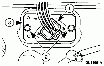

Blower motor resistor is located mounted to the blower motor housing
Have attached wiring diagram and a pic of the blower motor resistor location

It could also be the blower motor resistors. They are not hard to pull and would be worth checking. If you need any other information let me know
