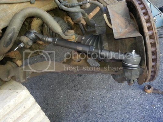

About the tie rods....I wouldn't let those go much longer if you think they are starting to have play. One of mine gave out years ago while driving like 20mph and it was a pretty scary experience

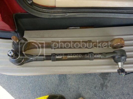

oh snap! my tie rod just broke. Thank god I was backing up in my driveway Not 70mph on highway. Now looking up parts for the weekend.....yay!

Told ya to watch out for it lol, you're very lucky you weren't going fast. My wheel turned completly inwards and skidded the car to a stop
