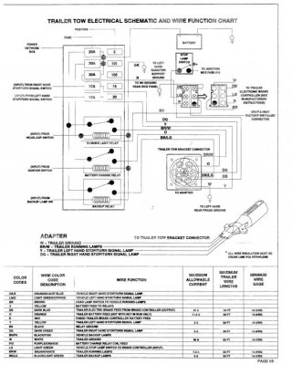

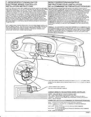

Does anyone have the fuse panel/relay panel schematic? I am trying to help my friend get his 99 expedition to supplying charing power to his travel trailer. I know it is probably missing the tow power relay and/or fuse. Thanks

Documentation supplied with my 99 Expedition XLT with Towing Package:
