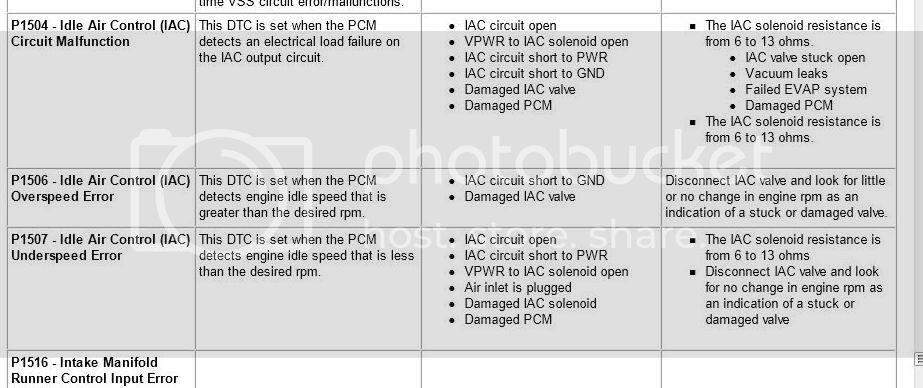

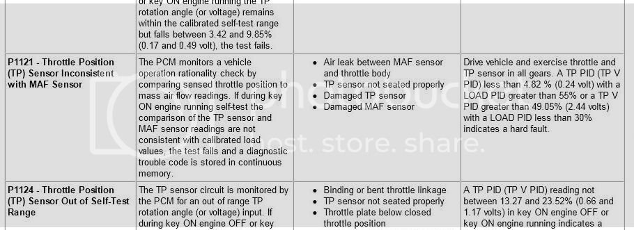

P1506 and p1121. I believe p1506 shows signs of vacuum lose or pcm trouble, p1121 because i have the maf partially covered (new tps). I have installed and remove the intake about 5 times now for different reasons( can do it in 1 1/2 - 2hrs now!). I smoke tested again today with a cigar. Had a leak at iac i have been told this is normal ford tsb. I blocked it off and the throttle body leaked at the return springs (dont know if thats normal). With me blowing harder a small leak appeared at the brake booster metal vac line mounting tab. None of these leaks respond to starter fluid. These is the third iac to leak this( 1 factory and 2 after market). I replaced the booster line engine runs the same. Could it b the throttle body?
