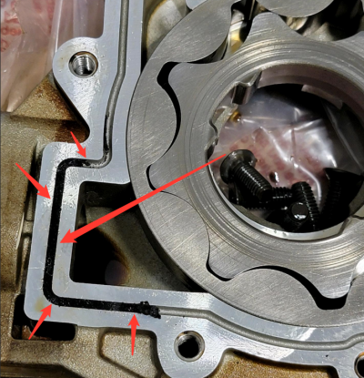

For those of you that recall I did a timing job to my 5.4 almost 2 years ago. I just wanted to let you all know the factory tensioners have failed again as of about 1.5 years of service and the chain slaps around very badly on startup. the truck going to the boneyard anyway because the transmission issues. The tensioners were Ford OEM and torqued to spec with a torque wrench. For any of you doing that job in the future I’d highly recommend skipping the factory style o-ring ones. I questioned this many times—how can the O-ring handle a new strong oil pump feeding it? Well the answer is it can’t. It will happen all over again. That’s why I was flat out against the Melling pump. Anyway, I’m done with the 3rd gens and the rusty rockers, the engine problems. Shopping for a new vehicle and never looking back. Just thought I’d share with any of you doing that horrendous job—get ratcheting tensioners.
shit, why didnt you post this a month ago lol.... just finished mine
did you take it apart to verify the failure, or just going off of sound? i havent seen any other posts of the new style failing. I too have concerns with the added pressure, especially with the new rollers having pin holes versus wide open holes that will keep more back pressure, but then i remember that the mustang uses the same tensioners and higher pressure pump (80 vs 60psi).
I am curious how the gasket fails on the new ones, the old gaskest seemed like a flat/platic gasket that just slid out, the new one is more silicone/thick and the groove seemed bigger.

the plastic tensioners have a spring, i do not believe they actually hold any oil pressure while engine is off (if there was, it would leak out the rocker/rollers or somewhere else down the line). maybe they fixed one issue and put a cheap spring in that failed.

OP, do you have pics of the tensioners? i am curious what the new seal blowout looks like, i havent seen anyone else having the same issue with the latest plastic version. I wonder if you have something else going on. also, reading on the mustang forums that while the cast iron tensioners dont have seals to blow out, they also dont seal up fully and leak a little, causing the VCT issues still.

No pics, I’m not opening it up. I’d assume it failed just like the old ones, heat and cool cycles hardens the once soft seal bead then oil pressure blows a chunk of the seal out and p*sses oil out the block.
big assumption to make, especially since it doesnt seem like there are any other posts of new ones failing, but tons of the old.... I would verify before I go posting unknown failures.
chain slap could be something else failed. did you get OE parts from a dealer or ebay/amazon etc?
