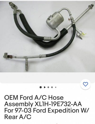

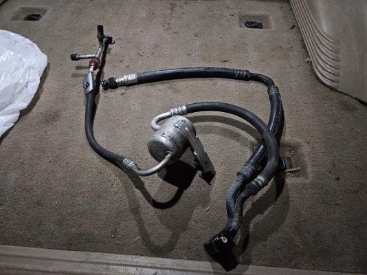

I have a 1997 eddie baurer with a 5.4, my ac hose assembly needs replaced and I found an nos one on ebay that has the same part number, but it has an extra port. my question is did ford change that assembly mid year?

There would be a fan unit and AC evaporator coil behind the third row. Also independent blend and fan controls for the rear. Use your VIN when shopping for parts.
