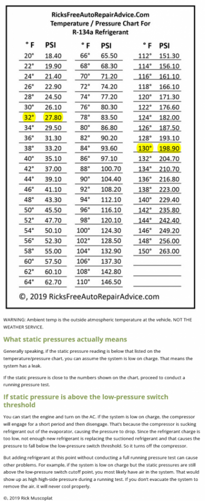

Today it is about 82F According to the chart and info below I should see, with the system off, a static pressure of 90.2 PSI. If less that would indicate a low charge, if higher would indicate an over charge. Is this correct?
UPDATE: I found the static pressure was 105 PSI, however the ambient temp (inside the car) much higher due to the car being in the sun for hours. I did open doors and run the fan a while which lowered it.
Withe the AC compressor running for about 5 minutes at 3/4 fan I got a low side reading of about 35 PSI which is 5 or 10 PSI lower than what it should start to be with the 82 F air temperature. My impression is that the refrigerant is slightly low. But it is cooling and the compressor does not appear to be cycling.

With a set of gauges. What's your low side, and high side pressures with the AC in the recirculate mode, windows closed, blower(s) on high and the compressor engaged. Not interested in static pressure, other than to say yes, there is some freon in the system before I engage the compressor, to avoid damage.
