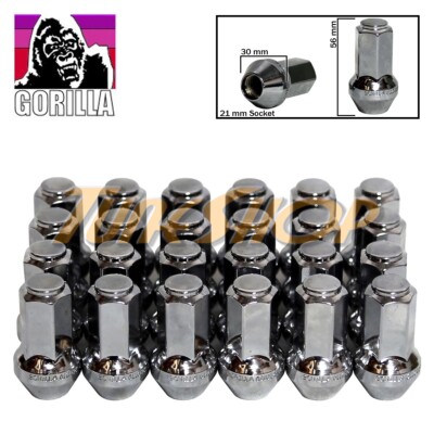

Just replaced mine with Dorman. I can't believe that there has not been a recall on this or lawsuit even. I'm just imagining someone's wheel falling off and getting hurt in an accident because the lugs were not able to be properly tighten to the correct torque. BTW I think the OEM lug nuts are 21.5mm. My new lugs are 21mm so I bought a 4 way to fit the new lugs.
Every Ford & Lincoln vehicle has the same capped lug nuts. Have for a few decades. Buy some aftermarket versions and pitch them first time.

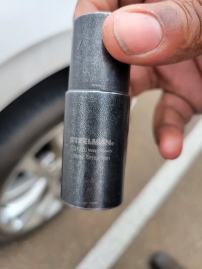

FYI - Most reputable tire shops have half sizes for their lug nut sockets due to the swollen nuts. Steelman makes a good impact.
