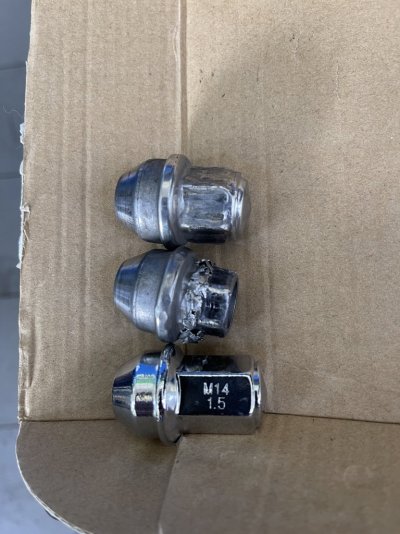

Got a flat tire on my 2018 Expy. I didn't realize that on the OEM lug nuts there is a flimsy aluminum cap over the actual nut. When I tried to remove the nuts the caps were either swollen and I couldn't get the lug wrench on or if I did they would just spin over the actual nut. It was impossible to loosen the nut or remove the cap with the flat tire kit provided. Luckily I was in town and my wife drove me to an autoparts store to buy a stripped lug nut remover. With this I was able to get the caps off but removing each cap from the extractor was a real pain on the side of the road with limited tools. Now I needed another ride home to get more tools to get each cap out of the extractor. What should have been a straightforward tire change in less than 1/2 hour ended up being an over 4 hour ordeal. I immediately got all my other lug nuts replaced with better quality single piece nuts at a local tire shop. Buyer beware that this doesn't happen to you in the middle of nowhere! Did a web search and there actually has been a class action lawsuit regarding this but it was dismissed. http://www.fordproblems.com/swollen-lug-nuts/ Maybe if enough people complain they will be forced to do a recall.

The McGards are real nice USA quality. Frankly, I think the original stainless-sheathed ones are fine if they are never used with an impact wrench or the wrong size socket. An impact tool or improper wrench applies pressure to the high corners and causes the flats to bulge. Just how I see it. I've had them for decades until a tire place destroyed them with an air wrench.
