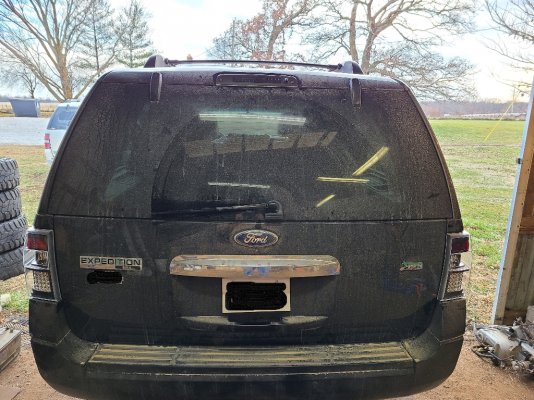

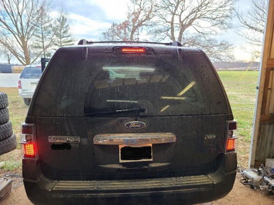

Ordered a bunch of LEDS from SuperBrightLEDs.com. Still need to do the interior bulbs but added LEDs to the Brake Lights, Reverse Lights and Middle Brake Light last night.

Not sure I'd recommend replacing the 3rd brake light unless you're fairly handy. I thought for sure I would be ordering a new light.
BUT, replacing the reverse and brake lights is SUPER easy and well worth the money and time spent. IMO
