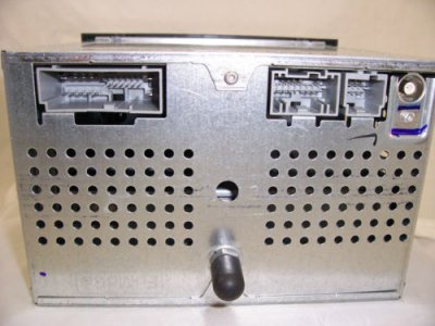

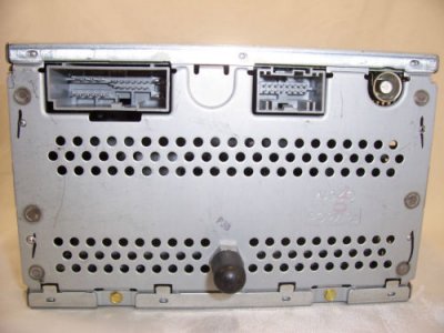

I believe the space is just empty if you dont have the factory sub. Easiest thing to do is pop off the rear tray piece by the cup holders in the 3rd row on the drivers side and look down. I've seen a few Expedition factory subs w/ enclosure and amp for sale on ebay, but the problem you're gonna run into is whether or not the wiring harness is back there and the fact that the head unit wont have a provision for the sub output. So at a minimum you're gonna need a new "Audiophile" head unit and sub enclosure with amp. Also, if you have SYNC you've got to find a head unit that works with that.
Factory Sub looks like this:
http://www.ebay.com/itm/11-Ford-Exp...t=Car_Audio_Video&vxp=mtr&hash=item2ebad48d98
Audiophile head unit will have three plugs in back, non Audiophile head units only have two. (see pics)
