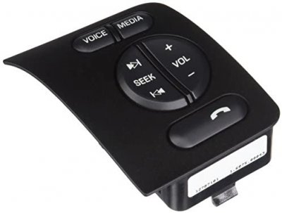

I have 07 expedition ext 5.4 wanting to add right side steering wheel media controls. Bought switch. No harness behind the old one to plug it into. Which I am now assuming means I need to replace clockspring. Controls I bought I believe are for 2012. Has only phone symbol on bottom button. Not temp. So would I be correct in assuming I would have to find a clockspring for 2012 in order for it to connect to buttons? But will that fit and work properly in an 07? Is the wiring harness the same behind the clockspring to be plugged in? Will I have to replace left side contorls as well? Or do I have to find the right side one with temp as bottom button and just deem them null? Not sure what to do could use some words

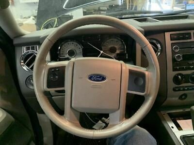

Yes I believe now that it is missing as well from what I am reading. Saw someone ordered a whole steering wheel just to get wiring for this same job but thread is dead cant get exacts. But this is what I ordered and this is what my steering wheel looked like before. Not actually my picture but you can get the idea.41MrrDepbpL._AC_SY1000_.jpg s-l400.jpg
