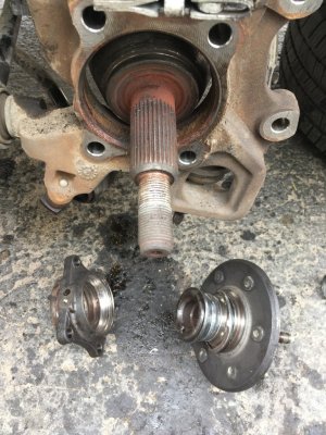

I had a similar problem a few months ago. I took apart and inspected all 4 brake assemblies, nothing, all looked good. I DID NOT have it scanned. I figured it was probably a bad sensor. Last week I experienced a full bearing failure on the left rear wheel/hub assembly, while doing 75 MPH. I'm assuming with the independent rear suspension and the disintegrated bearing is why it started fish-tailing down the I-10...Once I replaced the hub and bearing assembly no more ABS/ Traction control symbol illumination. I would suggest not delaying at finding the problem....
