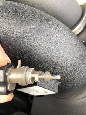

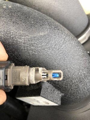

Finally got around to fixing this. The front pipe shifted upward when I was putting it into the filter, and was barely even in the coupler. Loosened everything up, pushed everything into place, and tightened it down; no longer hits the hood. In fact, it’s a perfect fit. Modifying the IAT sensor took ten minutes with a mini-hacksaw and some sandpaper, and since a new one is $6.71 shipped, it’s not a big deal if you screw it up.
Did some running around today, and I’m averaging 0.9 MPG higher than I typically do, so I’m calling it a wash. Won’t matter tomorrow when 5 Star sends me my new ‘Performance Plus’ tune.

Are you able to show exactly what needed to be trimmed on the IAT?

The area I circled in red. I pulled off that o-ring, and made everything roughly the same diameter as where the o-ring sits. That was enough to make it a press-fit into the hole where the 2014 F-150 sensor normally bolts.

I wonder if the F150 IAT has the same connector as the Expedition? And one just get an F150 IAT and not have to trim it.
