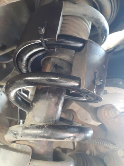

@Expedition Dave - Good thought... I’m curious about the answer. Might be ok because I only see zip ties on one side?
@Fozzy - Thanks for the suggestion. I’ll check them out. Anyone else thoughts or success with this or something else?

They do limit the off road travel of the shocks. They will compress a little. They are not a solid rubber. I have not had them come out or break the zip ties. When in heavy mud or salt I make sure to keep them clean so they won’t wear out prematurely and check the zip ties. I have the R/L 3/2 and 35” tires. I have stuck the rear tires into the rear fender wells and caught all of the carpet and ripped it out. These have stopped that from happening. If I didn’t love the ride and adjustability of the CCD’s I would run the ICON’s and spec out a heavier rear spring and sport 33’s. You could have someone make you a custom rear spring. But I think that would kill your daily ride quality. And you would probably have to play with the spring rate multiple times to get it right. This makes the Sumo’s a no brainer until Ford goes back to the air bag. Cheap and effective.

I also use the Sumo Springs on my 2018 Max Limited. Have towed trailers to CO and up mountain dirt/rock roads (I use the term road very loosely) without issue. They definitely help with some of the sagging of a heavy trailer or boat. Very happy with them so far.
