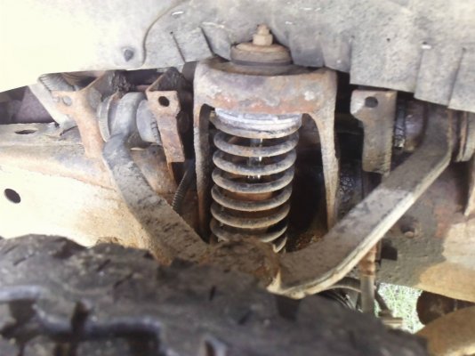

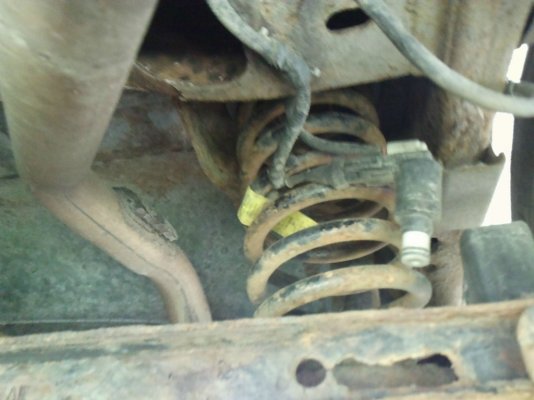

Ok, so I know there are a million suspension threads and I've read up on them. In fact when I got my Navigator it was one of the first things I looked at because my rear end sags.
I was all prepared to buy a coil conversion kit and get it installed. However, I was under my Navigator for the first time today doing something else when I spotted coil over shocks in the front and coil springs in the rear. WTF? Did somebody already do the conversion? It would explain why the air ride switch was off.....but if so why am I still saggy in my rear and how can I fix it?
Here's a few pictures of what I'm looking at.
Mediamonkey11
Jul 7, 2013
575
93
Enumclaw, WA
Yes, someone already did the conversion. I'd replace the rear springs and add a lift if it's in your plans! The front end looks lifted though...

Im with the monkey ^^^^! Someone swapped it for you. Buy the replacement coils to bring the back end up and might as well get the lift ones.

your front end is not lifted, its a weird look thing that I had to get used too. Your rears are bad and sagging, that is true, but its making the front look higher, but only sleightly.
I thought my rear end was bad, but then I looked closer at the trim, and the front wheel well is larger than the rear, and it makes the front look lifted - even though its not and its perfectly level.

You could always hide the sagging issue by taking a few turns out of the torsion bars and dropping the front end. That would take some weight off the saggy rear coils and level your ride out.

Best option would be to replace springs and add lift spacers so you can take them out if you'd like :)
