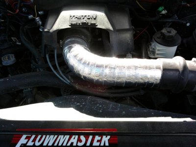

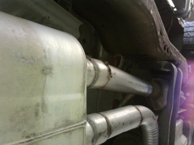

I still have my two rear cats for now, but I removed the factory Y and replaced with a DI/SO Flowmaster and also removed the rear resonator and I picked up power across the board ( low end and high end) not to mention about 100 miles per tank (if I can keep my foot out of it :D) I would recomend checking what panda said, and how many miles are on it? o2 Sensors? Now on days where the outside temp was around 95 - 100+ and I was driving in the city, I was loosing some low end but found it was due to heat soak on the CIA, wrapped it with a product by Thermo Tec and it took care of the problem. ( see last pic )

It does sound like you could be getting to much hot air, I had to order the hot air sheild from Airaid for my CIA and also like I stated before wrap the intake tube, but the reason I had to wrap it is because mine is aluminum. If you are running the plastic one those don't absorb as much heat but you definatly need to duct it to the fender or some where it can get cooler air. I am still looking at cutting the hole in the fender a bit bigger so I can duct it down behind the headlight area to make sure I can get the coolest possible air. I live in southern NM and during the hot days 95 + and I am in town I still have issues, but if it is around 85 - 90 the truck runs like a ***** ape and in the winter months even better.
