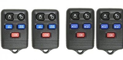

I’ve been out all day and just getting time to think. I have tried short press, long press, double and triple press. It completely ignores the power hatch remote button. I checked it with a parts store remote test display and that button does send out a signal.
I’m assuming I bought the wrong remote. There is one with words instead of symbols. The cut off date is between 07 and 08 according to some info I read on Amazon. The one I bought stated it was for an 08, but since mine was manufactured in Sept 07, maybe it’s the other remote. I really can’t afford to spend another $29 to find out that’s still not the problem.
