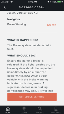

Twice now my Lincoln app has given me the below message. The first time I didn’t pay it any attention but the second time I figured I’d call the dealer. Truck is at the dealer now and they can’t find anything. Anyone else experiencing a similar issue? Truck drives totally fine and there haven’t been any alerts on the vehicle itself. The app has notified me each time the alarm has been triggered and once when the detail guy left the doors open so other than the brake thing the app has been correctly alerting me.4F7DFD9B-01D7-4615-80A1-92515617067F.pngACB39C68-C503-496A-9598-26EC0F8F476C.png

Is the Parking Brake out of adjustment?

Not sure. I use the parking brake and it disengages properly and the brake light turns off. Dealer came and took it to their shop and couldn’t find anything wrong with the brakes and there was no evidence in the computer of my vehicle having a brake issue. I got it back yesterday and Lincoln asked that I delete and reinstall the app. I’ll see if it happens again.

How did reinstalling the app work?

So far no issues. The dealer did a battery reset so I’m having weird Bluetooth pairing issues, already deleted connections there. I have to wait for phone to pair before I plug in charger. I don’t have car play activated either, gonna play around with it later today.
