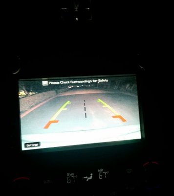

Dunno if it's the same system or not, but it seems quite likely... my '12 Lincoln Navigator camera has become extremely useful at night after just 2 simple mods:
1) LED license plate lights - already quite good
2) add LED reverse lights - now literally sees better at night than in daylight
Both mods use JDM Astar 194/168 LED bulbs (same as map lights front and middle row), had these on various vehicles for a couple years now no complaints.
Unlit FULLY DARK lot, contrast on screen turned WAAAY down (hate ambient lighting at night, it's annoying):
Contrast up, sparsely lit side street:
Bit grainy, but quite useable and well-lit
You need 4 bulbs, a 10 pack on Amazon is like 12 bucks...
4 more bulbs can be used to do your interior, or IIRC 5? for top brake light
