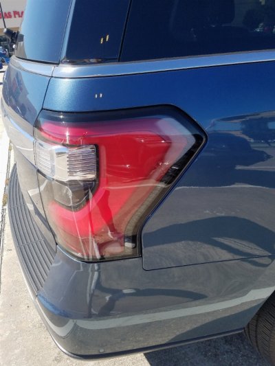

Both taillights have moisture in them. It rained last night here aswell. No excuse for ANY moisture to be in both taillights on a brand new car.
The foggy looking glare on the corners are all moisture inside.

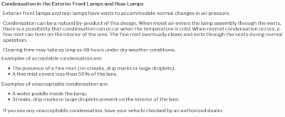

Im pretty sure they are supposed to do that...they have little cutouts for the moisture to get in and out. I believe the manual talks about the condensation in the mirrors. Someone also asked about this in another thread.

All light housings are supposed to be sealed units.

They are sealed, they have small holes in them. All of my lenses have condensation. Ill see if i can see the owners manual and find that line.

I know what your talking about, but those divets are from the molding process.
If they're saying they're designed that way, they're blowing smoke up consumers ass.
