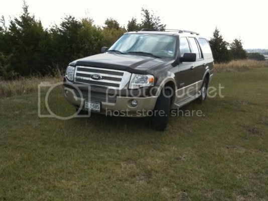

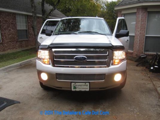

Starting working on wife's EXP.
Before
After
I have the lower billet ready to go but I cannot seem to figure out how to install it without scratching the hell out of it. May leave it off.

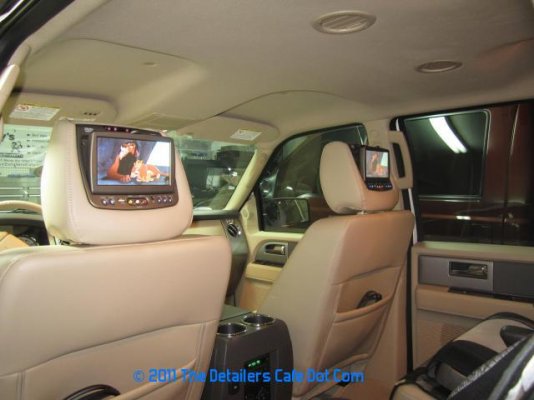

also, we got the head rests finally done too. Kids are happy, which makes momma happy and we all know what that means.

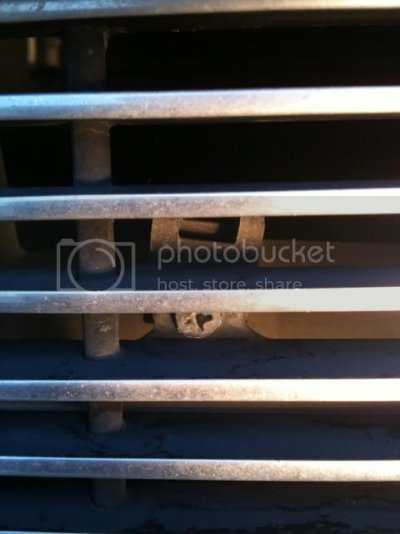

For the lower grill, I disconnected the rubber spash guard from underneath and laid on my back and connected it that way. It beat tearing apart the whole grill to get to the lower valance. Remembering correctly, it was a PITA. Try your best to get it on, so much of the lower radiator is exposed to possible rock punctures.

Not sure if we got the same grill system. can you shoot a close up of yours and does it flt flush inside or does it stick out a little?

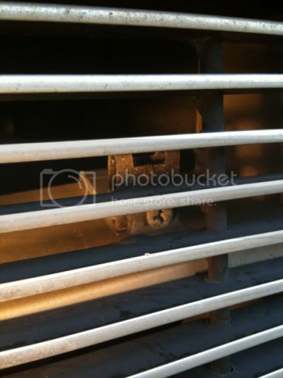

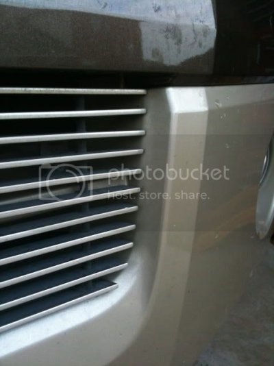

Mine fits fairly flush with the valance opening. It connects via the center plastic strip running in the middle using 2 hooks and a phillips screws. Here's the best shots I have...
Don't know if that really helps at all
you're a rock star man...nice use of light so I could see the screws in there.
That is very helpful, I gotta do some thinking and looking on this one. I think mine is a ilttle different. THe shorter screws wouldn't reach to the back of the lip using the clips so I need to probably take two out of another part and swap those screws out.
gonna play with it later tonight (insert joke there)

Ok, got it all worked out. Was able to swap a few screws from other parts and use the longer ones to get the hook brackets over the middle lip. It didn't cinch up like I thought it would and I didn't want to bear down on it to break that part. I think it will be fine and as of right now, no billet bars are touching any paint.

Yes, be gentle on the middle plastic. No need to bear down, it will show signs of stress. I installed mine back in 2008 and haven't touched the screws yet and don't plan to. Everything has stayed in place so far without issue.
