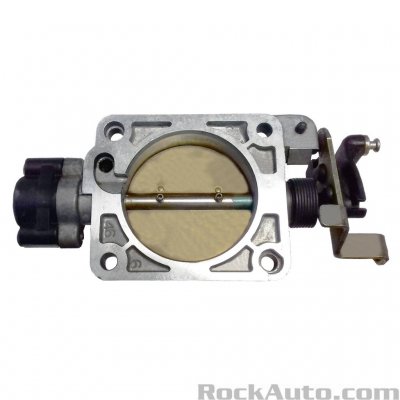

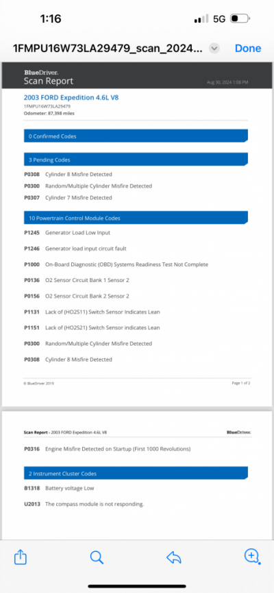

Hello. So I bought this at auction a few days ago. It starts easy but dies almost immediately. It only stays running with my foot on the gas a little. But as soon as I take my foot off it has a rough file and dies. It seems to want to stay around 400rpms. I was hoping just a IAC valve. I slapped a new one on but it didn't help any. These are the codes it has now. Also. The replacement iac from auto zone doesn't look exactly the same but still plugs in. IMG_8101.png

Also. The iac valve that was on the vehicle has a vent cap and looks to be for a 5.4. My replacement I put on does not have a cap but is definitely for a 3093 4.6. Would this be a problem?

What do the sparkplugs look like ? Clean the MAF . Is there an air filter ? Not K&N I hope. Look for vacuum leaks or smoke test the intake system with a smoke machine. Rotted vacuum lines are common at that age. Cylinders 7 & 8 are the two rear cylinders on the driver's side for those misfires. Pay close attention to their sparkplug & coil condition. Any service records with it ? I hope you didn't pay much for it.

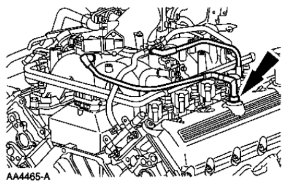

Ok. So now it's home I got up on a stepladder and I hear a hissing. I stuck my finger behind the engine and I feel a hole. It's the pic valve. There is no hose attached to it. I stuck my finger over the hole on the valve and all the bad idling stopped immediate. I see way behind the valve that there looks to be a hose that's not connected to anything. I'm trying to find a way to fish it out but it's tight. I can't seem to find a diagram on where the other end of the hose should be. Any help would be rad.

I suspect the hole you feel is for the PCV hose in the center back of the intake manifold. If so I suggest you replace the entire assembly as many of us here have.
This is a diagram of the PCV hose routing from the back right of the engine:
