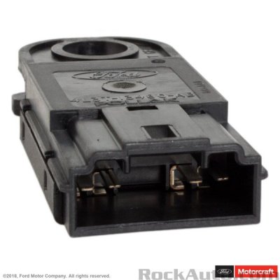

I checked all fuses, which were ok. So, I turned on my hazards and drove to nearby auto parts store. Discussed problem with manager who speculated that the brake light switch might be bad. So, I replaced, and that seemed to fix the issue.
Drove another 300 miles today with brake lights working fine, but now I am having a different problem that seems to be related to the switch.
After starting the vehicle, foot on the brake with lights on, it won’t shift out of park. “Wiggle” the brake light switch a little up or down, and I can shift out of park. There is an audible “clicking” sound when I wiggle the switch.
Depending on how I position the switch with a wiggle, the brake lights will work and I can’t shift out of park, or, shifting is easy but no brake lights.
So, I can wiggle the switch to shift, then wiggle again to get brake lights and drive fine. I can also use the button under the steering column to override the shift lock.
While this is somewhat of an interesting anti-theft situation, I would like to repair whatever is really at issue here.
Did I install the switch incorrectly? I am putting the bushing on the before installing the switch if that makes a difference.
