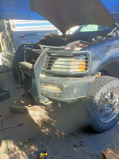

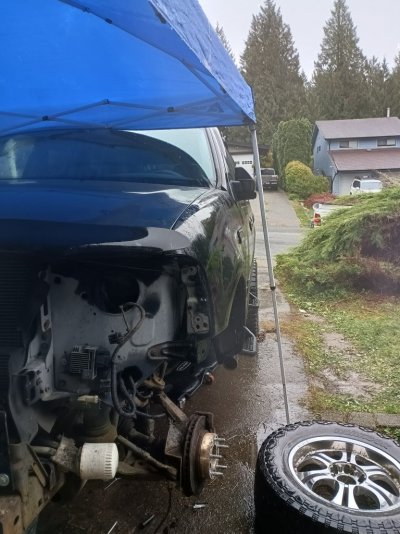

Jacked up starting to pull the transmission now. Hoping weather holds well enough. Have rain and even snow in the forecast. Super lame.

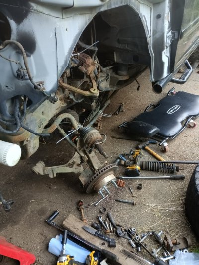

Things have gone poorly.
I've got the transmission disconnected, and enough space to pull the flywheel. But not enough to torque the new one on.
The bracket I need pulled is the torsion bar bracket. Super gay. So now I'm pulling my front end apart playing a game of mouse trap with things that want to strip and break.

Well, today has been a fight.
Got the torsion bar bracket out.
Then still couldn't get enough space till I finally walked over to the passenger side and clearly saw the transmission cooler lines... Well with that loosened, wouldn't you believe it. She slid back.
Got the old flywheel off, then tried like 4 different positions till I remembered the fly wheel would be balanced and keyed only one way. Worked really well after that.
Fought the torsion bar bracket for a while, swore to and at future, current and long dead gods.
Was much easier in my f150 7700 when pulling the bracket to put the lift in.
Now she's going back together.

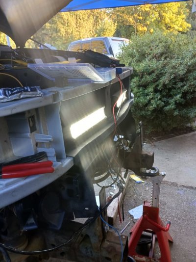

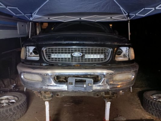

Got tired of laying on my back getting pissed on, so I put some body panels on and lined up the hood, and installed the bug deflector.IMG_20231024_155931_791.jpgIMG_20231024_155941_033.jpg
I totally didn't half install the fender before I remembered the antenna cable or anything...
