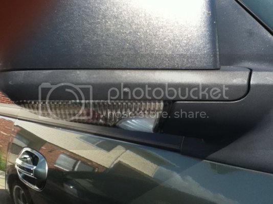

FREEWAY So you are saying i can move the mirror up. And replace the bulb without actually removing the lens itself? TIA
not at all...move the mirror up to push the clip out so you can take the lens off...you'll stick your flat head screwdriver in the gap of the mirror...theres a hex screw underneath holding the lense in along with the clip thats inserted...
