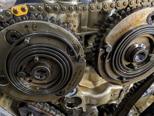

Long time lurker, first time post--it's kind of long.
I've learned a lot from posts on this forum and wanted to post about my experience completing cam phaser replacement in my driveway this past weekend to contribute something back. I have a 2018 MaxXLT with HD tow. I have 95k miles.
My symptoms were the typical clatter at startup, and the hot idle knock. Both got worse quickly from when first noticed. It took me about three months from deciding I was going to do it, to ordering parts, and getting most of them in. I put about 2k miles on it during that time. I also never got the driver side valve cover nor the intake gaskets that go between the valve cover and the heads--still on backorder. Ford officially says it's okay to reuse those gaskets, and while I was concerned about having a cracked driver side cover, ultimately it looked good. I was willing to risk it at this point because if I still need these they're at least near the top of the engine and I can just do these later rather than putting this off longer.
I used all Ford/Motorcraft parts. In addition to the phasers I replaced the chains, guides, tensioner arms, tensioners, timing gear on the crankshaft, water pump, thermostat, VCT solenoids, spark plugs, high-pressure fuel tube, and belts. Of these if (and only if) I needed to save costs and now having seen the condition of the parts I would have kept the originals in this order--timing gear sprocket on camshaft--no real wear here, timing chain guides and tensioner arms--not much wear, VCT solenoids--on top of engine at least and I had no reason to think they were bad, just old, tensioners--I've not heard of them going bad, but if they do they're hard to get to, chains--the new ones did seem tighter with less tensioner travel, though. With my miles and age I definitely would replace all the other stuff. My water pump was close to being ready to leak, not from the bearing, but there was about a two inch section of gasket that had pitting and corrosion of the mounting surface under it. Thermostat was original. Spark plugs didn't look bad, but did have a slightly larger gap.
There were a few things that don't really get mentioned that caused a little more temporary grief than the obvious things. Here are the few things I encountered that I haven't seen mentioned elsewhere. I know they sound dumb, and maybe you have a better idea for dealing with them. I'm not saying any Ford engineer would be happy with how I did it, but it worked.
1. The bracket at the front of the valve cover on the passenger side that has heater hoses and both turbo tubes attached. I didn't disconnect the passenger side tube from the intercooler, and I think I would if I did it again. I wouldn't have had as much trouble fighting with that bracket which didn't seem to have as much play as I needed to get stuff out of the way.
2. The stud at the bottom of the front cover that holds the transmission cooler tubes and an electrical bundle. It's long and requires more movement from the brackets it holds than they're willing to give easily. In the end I ended up cutting about 3/4 of an inch off of this stud so that I didn't need to move the bracket it held as much when putting it back together. I just pried and fought with it taking it off. It didn't need that extra length anyway--at least in my mind.
3. When putting the crankshaft pully back on I didn't have a special tool. I tapped it on a little, got a thinner washer than the one that holds the pully on and was able to get the bolt started. I pressed it in by hand slowly until it went far enough that the engine wanted to turn, then I used an impact to seat it.
4. The front cover. I would not have been able to meet the 35 minute max time from applying the gasket material to having it fully torqued without a power ratchet of some type. You start by torquing 6 bolts, then you torque the other 18 bolts, then you go back and torque all 24 of them, all in a specific order. I used my air ratchet to get the bolts run in, then I went through torquing them. I did it in just under 34 minutes. I also didn't use the special alignment pins. What I did do was try a couple of dry runs of positioning the cover with no sealant, then once I added the sealant I used the two bolts where the guide pins would go to help position it. That was no problem at all. If I had needed to, my plan was to go purchase two similar bolts at the hardware store and cut the heads off to slide the cover over them. Not needed, though.
5. The magnetic grabber was a useful tool and I recommend getting one if you don't have one. Knowing that I have on occasion dropped things I replaced the VCT solenoids while the front cover was off. It would not have been a happy moment if I had dropped one of those bolts down in the front cover.
My phasers were pretty bad, but they were the CB release. When turning the engine over with a wrench three of them appeared bad--would cause the cam to jump and click--both intake and the drivers side exhaust (exhaust wasn't as bad, and maybe I saw the effect of the intake jumping instead). They appeared to fail all around the same time. I wonder if when one goes bad, the strain of it fluttering or its possible change in oil flow causes the other on the same head to fail?
At any rate, I'd definitely do it again if needed. It's a big job but I'm satisfied with the quality of the work and replacing all the parts I did compared to someone rushing through it and doing just the minimum--provided it's not under warranty. I wouldn't do it if someone else would do it at no cost to me. I'm not a professional mechanic, but I've always done a lot of my mechanical work and approach jobs like this with an attitude that I can follow instructions, I can turn nuts and bolts, and at every single step I can make sure I'm satisfied with the result or figure out what I need to do to be satisfied before going on to the next step. Just take it one step at a time. It took me about 20 hours. I'm sure plenty of that was referring back to the manual to get torque settings--every bolt has them. Here's a list of the parts I ordered. Prices are for the quantity ordered, not each.

Thank you @Jon2099 for a thorough write-up. Question: I didn't notice the VCT units themselves in your parts list. Are they the Engine Timing Camshaft Sprockets? I would have thought VCT units were much more expensive...
J
Jon2099
Nov 7, 2022
21
54
Indiana
Thanks for the warm welcome. Yes, the VCT units are the camshaft sprockets. It turns out I got the newest intake units and the slightly older CD units for exhaust. When I ordered, Ford recommended the CD units for the Expedition, probably to avoid having inventory sitting around. The CD's weren't available for the intakes then, so they subbed the newer ones. At any rate being a few months after I put my order in I'd probably try to get the latest release of all of them now even though the exhaust seem less likely to fail.

Hi Anaclya,
I used a few resources and spent some time preparing. I watched a series of youtube videos on a Gen1 ecoboost, which isn't exactly the same, especially the timing setup, but it does cover a lot of general things that were helpful about cleaning gasket surfaces, torquing bolts, etc. Search for FordTekMakuloko 3.5 ecoboost. I also watched a two video series on the gen2 ecoboost also on Youtube. Search for Ford Ecoboost 3.5 VCT Phaser Cold start rattle replacement Gen2. I also obtained a shop manual online, pretty cheap, around $25. Seemed a little sketchy, but it was exactly what I needed. I searched for 2018 Expedition Service Manual. It was a PDF download for the 2018 Expedition and was the complete shop manual covering all systems and had the electrical diagrams. Just make sure what you are getting is for the 2018. A lot of those sites may indicate it is, but then when you dig into it further they're actually showing a gen1 ecoboost.
Once I had the manual, I printed out the sections I needed and put them in order in a binder. It was useful for torques and the order for installing bolts on some assemblies, especially.
The biggest thing you could do wrong I think is have the timing chain wrong, or jump. The second video I mention above goes into quite a bit of detail about setting up the timing and ensuring the slack is on the tensioner side.
I'm happy to answer any other questions you might have, and good luck. When I was done mine started right up. It's not a job for a first time under the hood person, but it's also not what I would call a super technical job either, just a lot of stuff to come off and go back on that takes time.

Sorry to resurrect an old thread, but I saw the recent reply and am having some issues on my job on this motor.
Mine's not on an Expedition (though a couple years ago my son and I replaced the phasers on our 2010 Expedition 5.4L - that job was much easier), but a 2018 F-150 - same 3.5L Ecoboost.
I've done the research beforehand, bought all the parts from a local dealership at fortparts.com prices. I went ahead and got all the optional seals, etc as well as all the timing components and a new thermostat / seal as well (I saw a couple videos saying that customers had come back shortly after this job was done with overheating issues and the thermostat was the reason).
I'll do a write up afterwards regarding my job, but right now I'm stuck on a particularly frustrating problem.
I can't get the old phasers off. The bolts are so torqued on there that I've already stripped out two of the bolts. The first stripped bolt, I tried a large electric impact gun followed by a large breaker bar. I figured on that one, maybe the impact gun weakened the splines in the torx bolt, so I tried just using the breaker bar. Nope, that one stripped out as well. On those two, I'll end up having to cover everything except the phasers with plastic, then grinding them off. I have a feeling the other two will end up the same. Has anyone else had this issue? In all the videos I watched, the bolts either came straight out with just a bit of resistance or the video skipped past the part of breaking the bolts free.
I'll probably just move on with the grinding, but I'm curious what others' input will be. I thought about heating them, but I'm worried about doing damage to other components in the area so I won't do that.
Thoughts?
Thoughts?
No impact gun to be used on torque to yield bolts (similar to head bolts). You can zip it out with the impact gun after breaking the torque.
Are you sure you are using the correct torx bit?? These can be tricky since a smaller one will still fit but will lead to this damage.
Also for extracting them, not sure really what to do! Perhaps using a Dremel and many cutting disks.

I've had luck pounding a smaller socket onto a stripped bolt, maybe you could tap the next size up in there?

I'm not an expert at extracting stuck bolts, but there are plenty of people who are. Suggestions I've seen in the past include ones you've already heard here, welding a nut on the end if you are a welder and have tools, some specialty extraction devices like easy outs, or grinding the head of the bolt off so you can reduce the torque and get a hold of the bolt after removing the sprocket. The biggest enemy you have is that these are torqued really tight and some of the things that might work for low-torque applications won't work here. Grinding would make a lot of small particles in all kinds of areas where you don't want them, so a very thorough cleaning would be needed if you did that. Using some heat might help whatever route you take. I figure a machine shop can get them out in short order, and a flatbed tow there and back might also be a cost-effective choice that's a lot less frustrating. Sorry I'm not a lot of help, just throwing out some things that will hopefully help trigger a great idea. Others with more experience than I have may scoff at some of these--I'm okay with that. If you have someone else do it they may not preserve your current timing setup. Just be sure to get that back to where it needs to be upon reassembly.

I don’t think welding will work due to the high torque. Before trying welding or grinding, I would recommend trying a rocket socket rounded nut extractor. These will bite into the bolt head and can take some torque.
Oh, and I just realized the correct bit is not a regular TORX. I think it is a TORX plus.
