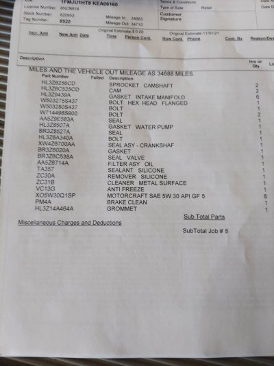

Just got back my 2019 expedition for Cam Phaser repair along with #21B10 reprogram and 21N03 repair. Here is a list of campaign parts used to repair Cam Phaser repair.
