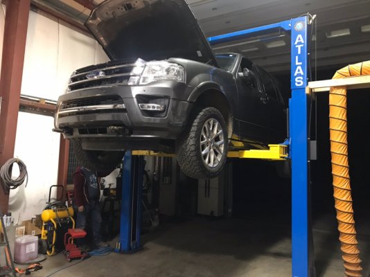

Can someone familiar with the Ecoboost help a guy out? Truck is puking coolant into the ground and I can’t find where it’s coming from. I’ve had the truck on a lift checking with another guy and neither of us could find it. Both turbo coolant lines are dry. Water pump appears to be dry. No coolant hoses appear to be wet. I can’t for the life of me find this. I removed the skid plates and the only place it appears to be coming from is the power steering area where the large power steering box is. Is that thing cooled by coolant by any chance? 78cd848eb607492ed0dba0d168c9534e.jpg
