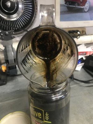

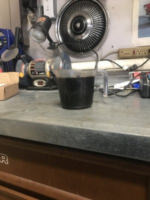

Here is an update on total oil caught with my catch can since I installed it with 8,000 miles on the 3.5 EB. I now have 30,000 miles on the clock so this is a total accumulation after 22,000 miles. I dumped the oil from the measuring cup into a storage jar and also noticed it had a soot like carbon residue sediment on the bottom. This could’ve been in my intercooler or baked on my valves.CEB4F70C-1704-4DED-B1A3-F40AE5BE8CC8.jpegCEAF37D2-84E3-4966-B414-E1CCF729BCBD.jpeg

Excellent info! Thanks!

My math right? 8oz over 22K miles = 0.36oz/1000 miles. (Intuitively matches my estimates each time I drain the can.)
-- Chuck
Actually that measuring cup is 2 cups and it was a little over the 2 cup line ......so it’s really close to 1 fl. oz. per 1000 miles.

Damn! All that dumped on the valves otherwise wo a can. What bean counter came up w that design?

Any DI Motor has the issue where this causes buildup. Just ask a modern Audi or VW owner.
Ford actually has addressed this issue partially in the Gen 2 3.5, by adding port injectors back. They have the secondary function of helping to keep the intake valves clean.

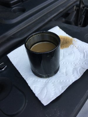

Completely full of "chocolate milk" this morning. Can extension ordered. The dual catch cans on my 'lil Honda S2000 have sight tubes to show the level inside -- still not enough to dump after 3 or 4 years on this NA intake car. Only bought those catch cans 'cuz all the other cool kids have them. ;)

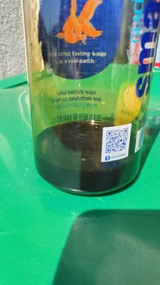

WOW! I can't believe it's been 1 year almost exactly since I did the install. I did the 1st empty today. Due to COVID and the kids doing E-learning from home, we've put about 2,200 miles on the truck over the last 12 months. There's probably about 2 oz of mostly oil. I've read water condensate is worse in the winter/cold temps, but we're in Florida and it was hardly driven this winter. Is it worth the money? I don't know. But I'd rather have that oil in a bottle than in the intercooler or cooked on the intake valves.

keep in mind 2200 miles isn’t even an oil change interval.
