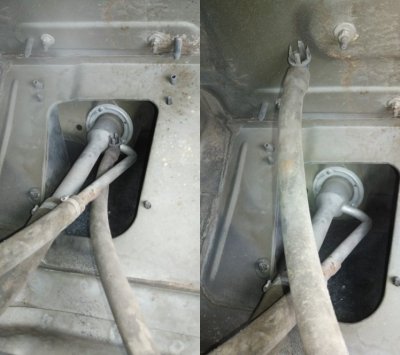

Bonnie threw a P1450 code and I'm wanting to figure it out. I did look around under the truck while she was on a lift getting an alignment and found a disconnected hose that is in the picture.
Does anyone know what it's supposed to connect to? I didn't find anywhere it could connect to so if someone could crawl under their 2003 or 2nd Gen and let me know I'd appreciate it.

Doesn't connect to anything on that end. It's usually just tie-wrapped to one of the other pipes there. It's just a vent hose for the fuel evap system. Don't plug it. When you remove your gas cap after driving do you hear a big hiss or the sound of pressure being relieved ? Check the condition of the vacuum hose from the motor over to the evap purge control valve there by the master cylinder, it rots out after about 10 years. If that looks bad change it out. Then it might be the control valve itself gone bad. Those are the common causes.

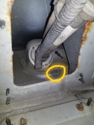

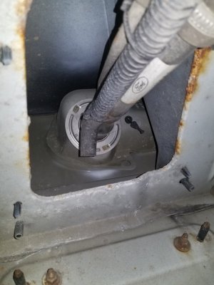

This is off of my 05, looks to be a much bigger in diameter breather hose on mine.
You're looks like it has a clip that connects it to this little cutout

I thought the same however, the diameter of the hole is smaller than the clip with four little prongs as well as being just shy of long enough or angled correctly.
This is why I felt that there was something missing from there that was an intermediary connector.
Edit: mine also had the zip ties which I cut off to search for where that 'connector' went to. That 'connector' seems like it belongs somewhere although yours doesn't seem to have it.
Even more confusing...
