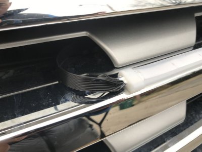

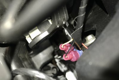

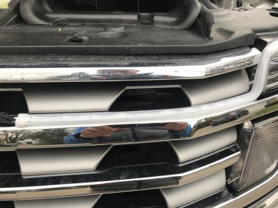

Here are the pictures showing how the strip sticks to the grill and light housing, the wiring through grill, the wire tapping to the signal bulbs.
