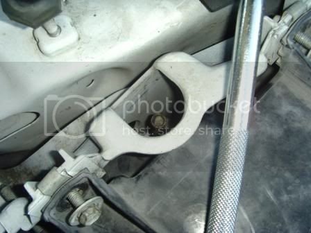

2) Take off the top two screws on top of the headlights. They look like this:

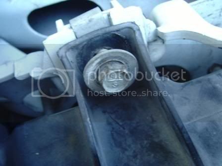

3) Loosen the screw in the back of the headlight. I think it's supposed to be an alignment screw, but it's never really worked for me. Here it is:

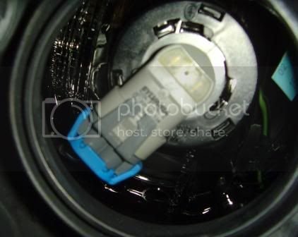

6) Unplug the plug that goes into the bulb. I think in this view, you turn the bulb counter clock-wise, and pull the bulb straight out. Here's a shot of it:
7) Connect the plug into the new bulb, and put it in carefully back in, lining it up with the notches. Turn the opposite way you did to take it off.

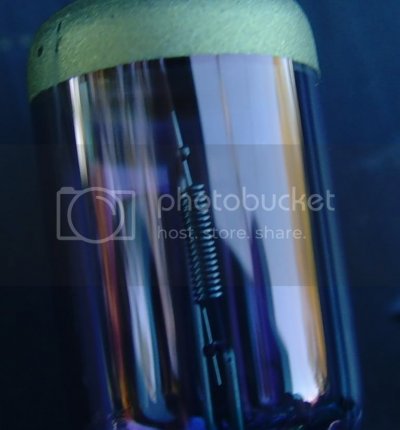

Here's a pic of a year old Silverstar:
Seems the filament was starting to burn?
