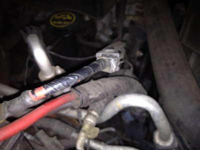

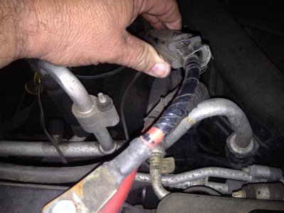

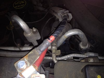

I do have a multi meter and test light, looking at the alternator harness I discovered this....wondering why there is black tape here?? Maybe some corrosion underneath? Will look closer tomorrow after work....received_10155483950823962.jpeg received_10155483950823962.jpeg received_10155483949858962.jpeg

Yeah clean and sand connections to battery and body ground first

Nothing wrong with the idea of cleaning all the connections - but it doesn't tell you if you have a resistance problem with the cable.
With voltage drop testing you don't disturb any of the connections. The reading on the meter will tell you how resistive the connection is. Total circuit vd should be less than .5v
