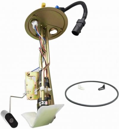

Check the connector (shown) for corrosion. Clean with contact cleaner spray, squirt dielectric grease in connections (male and female).
