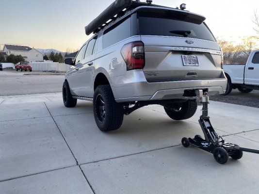

Put the Sumo coils spacers in tonight. I was worried with the 3/2 lift the springs would not open enough. But no problems. Left the tires on and used a board to push against the tire and pop them in. Super easy. Took me about 1 hour that includes dropping one and putting it in without checking if I put the deep grove in the bottom and had to take it back out and flip it. Took it for a drive and I can’t tell much difference with the CCD’s. Big test will be what my squat is with the boat on this summer.
