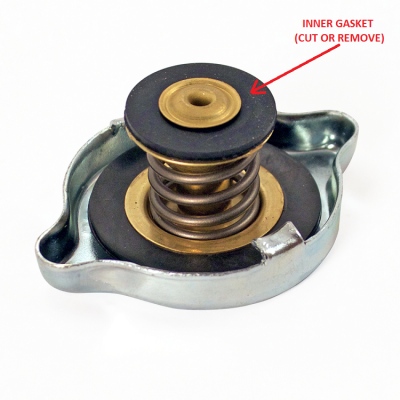

One thing that I did for like 15 years on my 99 Explorer was to cut the small (inner) radiator cap gasket to de-pressurize the system, following some advice I got from a mechanic friend of mine. This prevents any small leaks in the system by eliminating pressure and can be used as a cheap emergency procedure as well on cars or trucks that are ******* coolant when hot (due to bad hoses, gaskets, pinholes, etc).
I drove my truck like that with a de-pressurized cooling system for 15 years, without any adverse effects. The only negative thing it does is lowering the boiling point of coolant a little bit, but that's all. Your car/truck should never get hot enough for that to actually matter.
